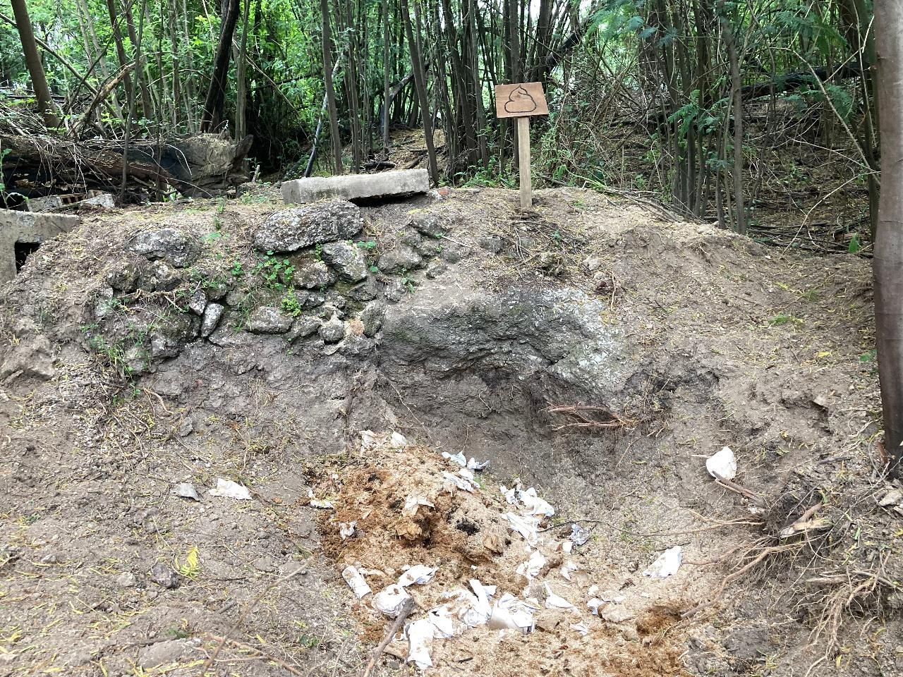

How our current system works.

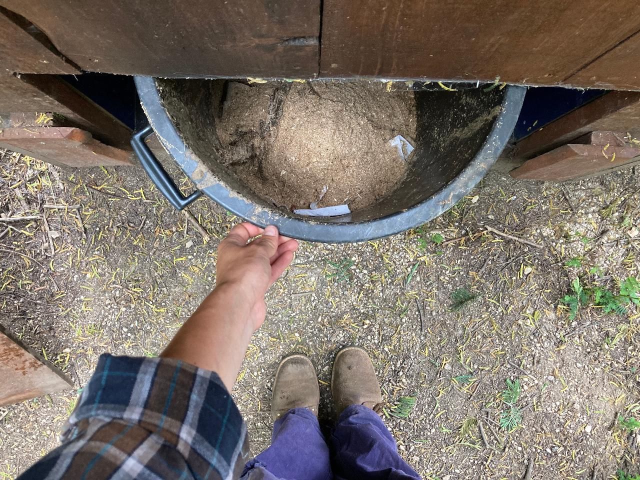

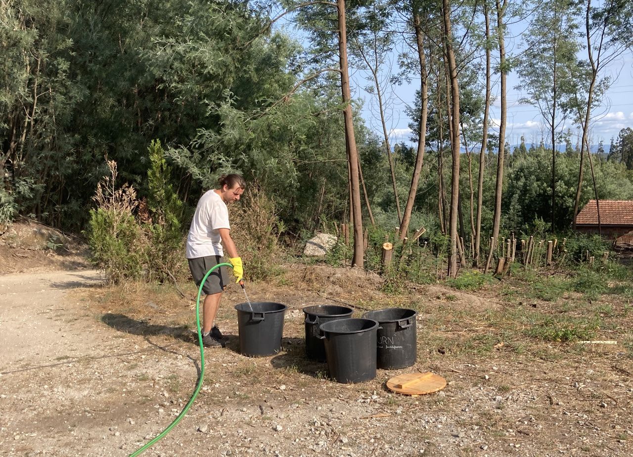

Our toilet setup is pretty simple. We use a big 40x40cm bucket to hold our poop, along with some toilet paper and sawdust that we pick up at the local lumberyard. Everyday, we empty the bucket into a big hole we’ve dug nearby and cover it with some dirt. Then when it’s full we properly cover and flatten it and dig a new hole close by. Currently we ask everyone to pee around Base Kamp between the trees and bushes but we also allow them to do it in the bucket if they prefer.
Challenges with the system.

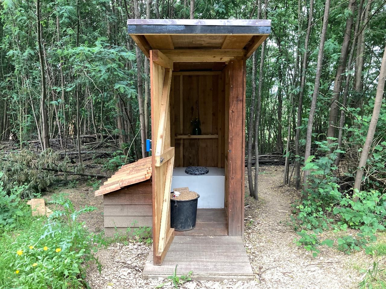

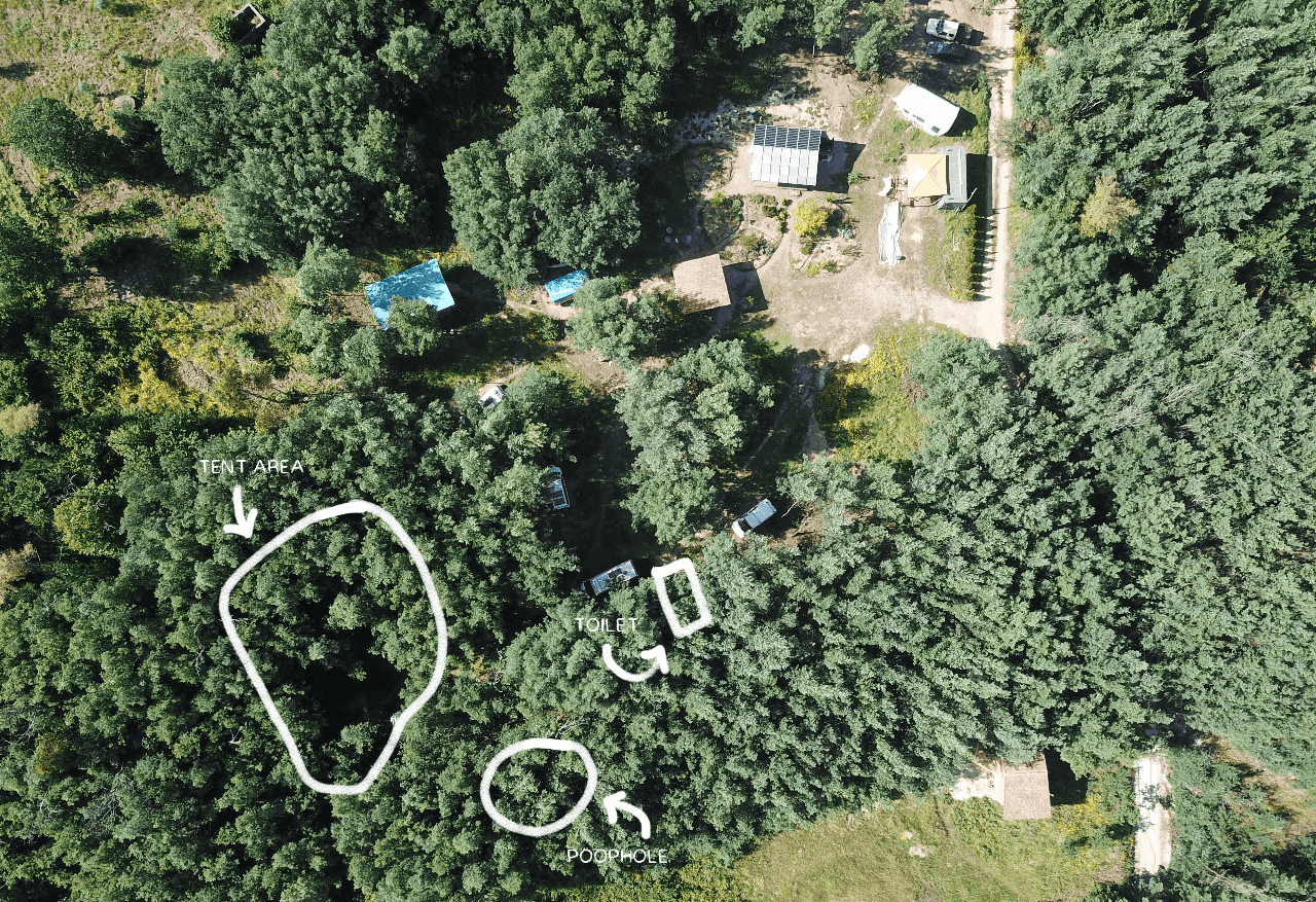

The toilet we built in the summer of 2021 is the only one we have, and we're still using the same system. But as the group gets bigger and bigger, we've started running into some issues. The main challenges are: Poop holes: -We're filling them fast. -It's getting harder to find good spots to dig new ones because the area is too rocky. -Digging them is too labor intensive. Pee and smell: -The poopholes are so close to the tent area that sometimes the smells get carried by the wind. -We are running low on bushes to pee privately and can also add to the smell issue. Extra improvements: -We feel like it's wasteful to just bury our poop, and we'd like to find a way to use it as organic matter instead. -We have limited dry space to store the sawdust, forcing us to go more frequently to the sawmill.

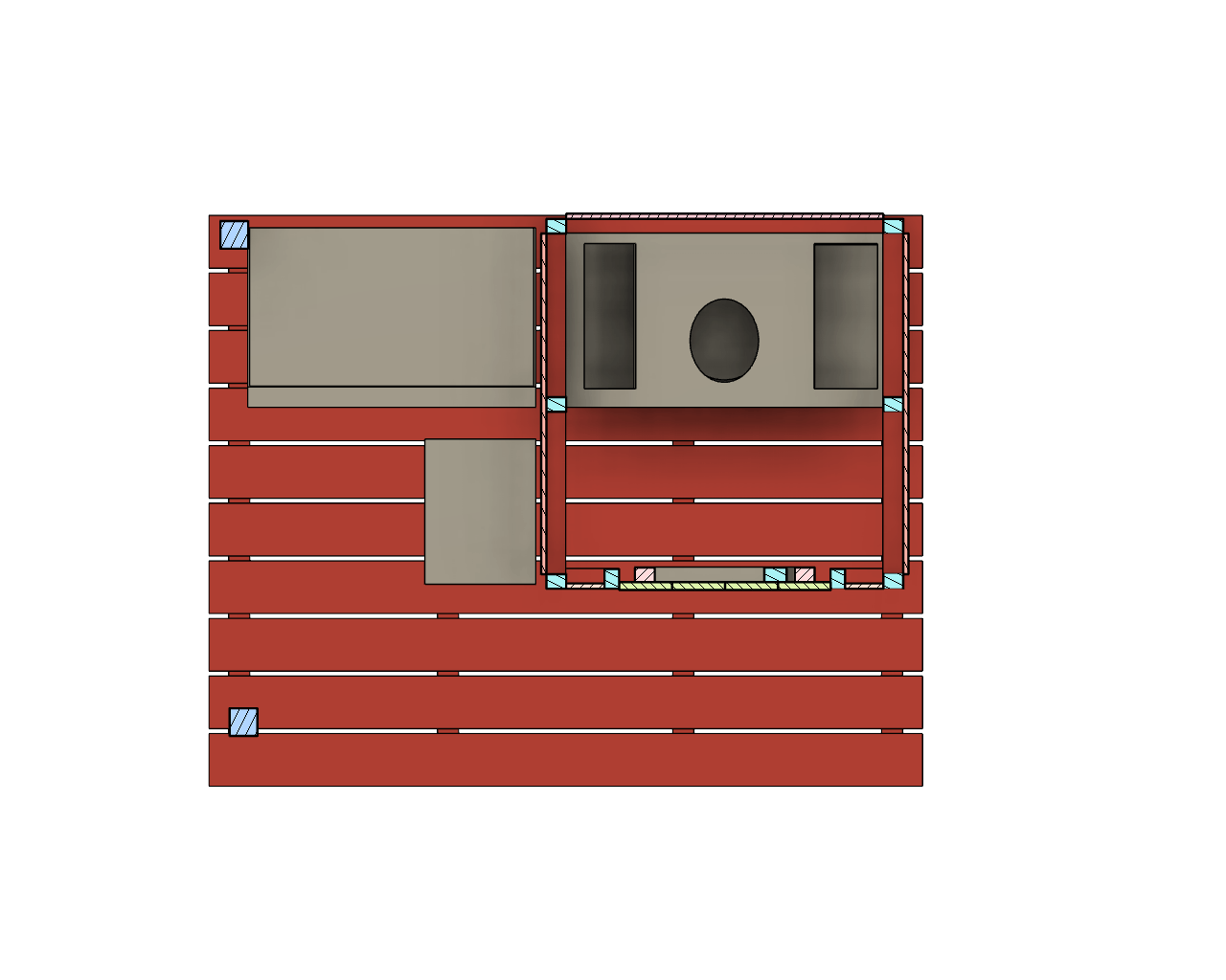

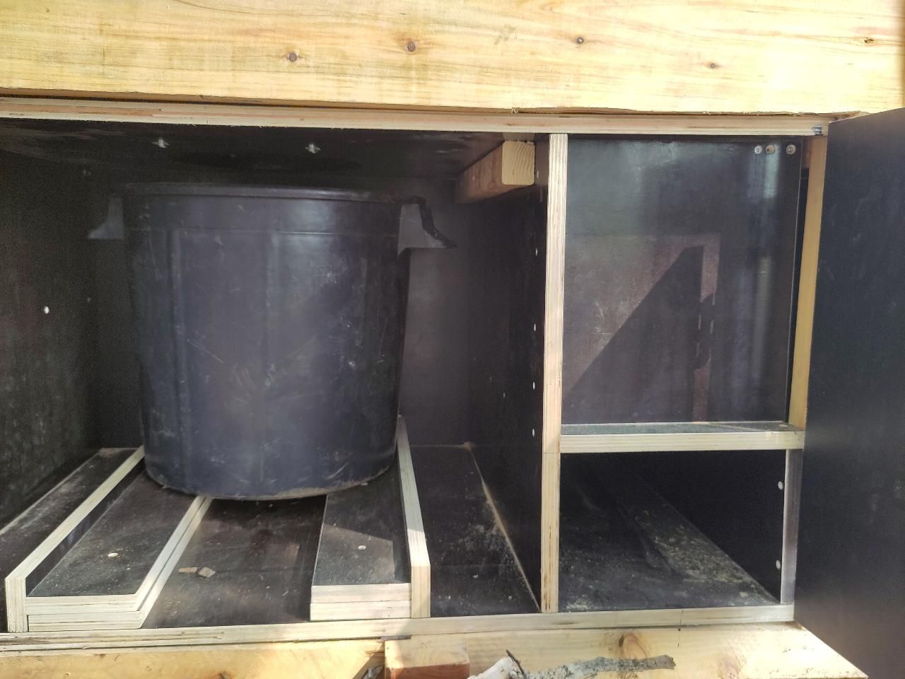

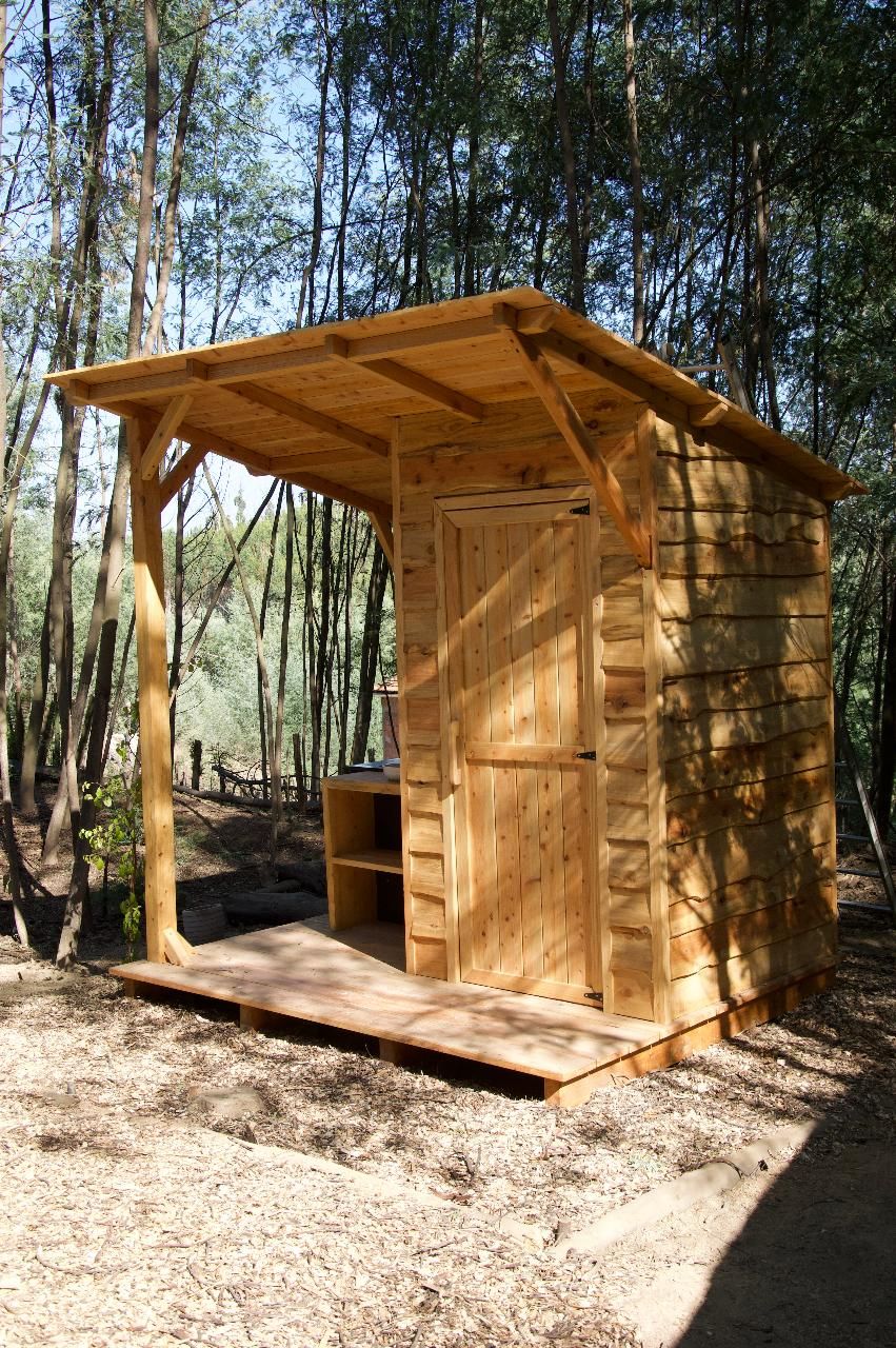

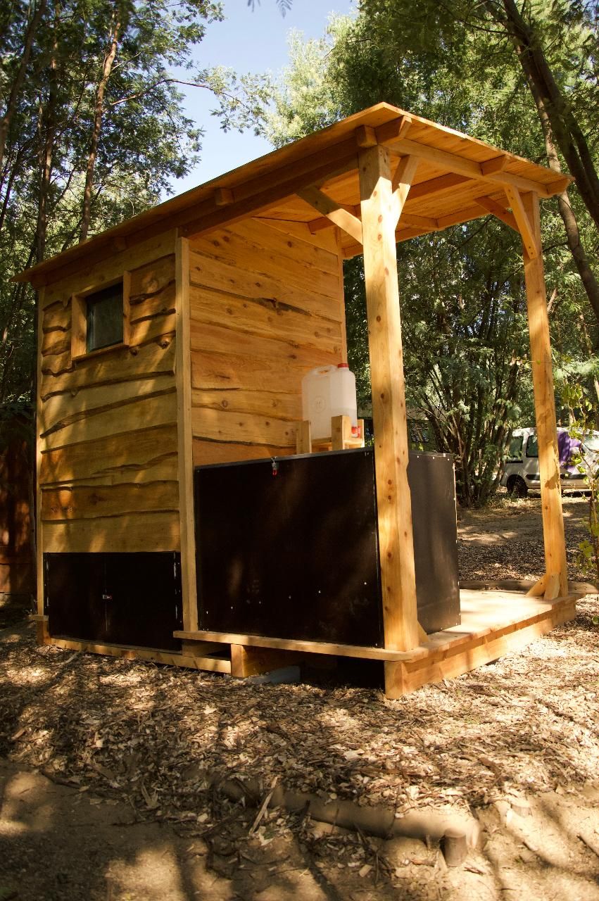

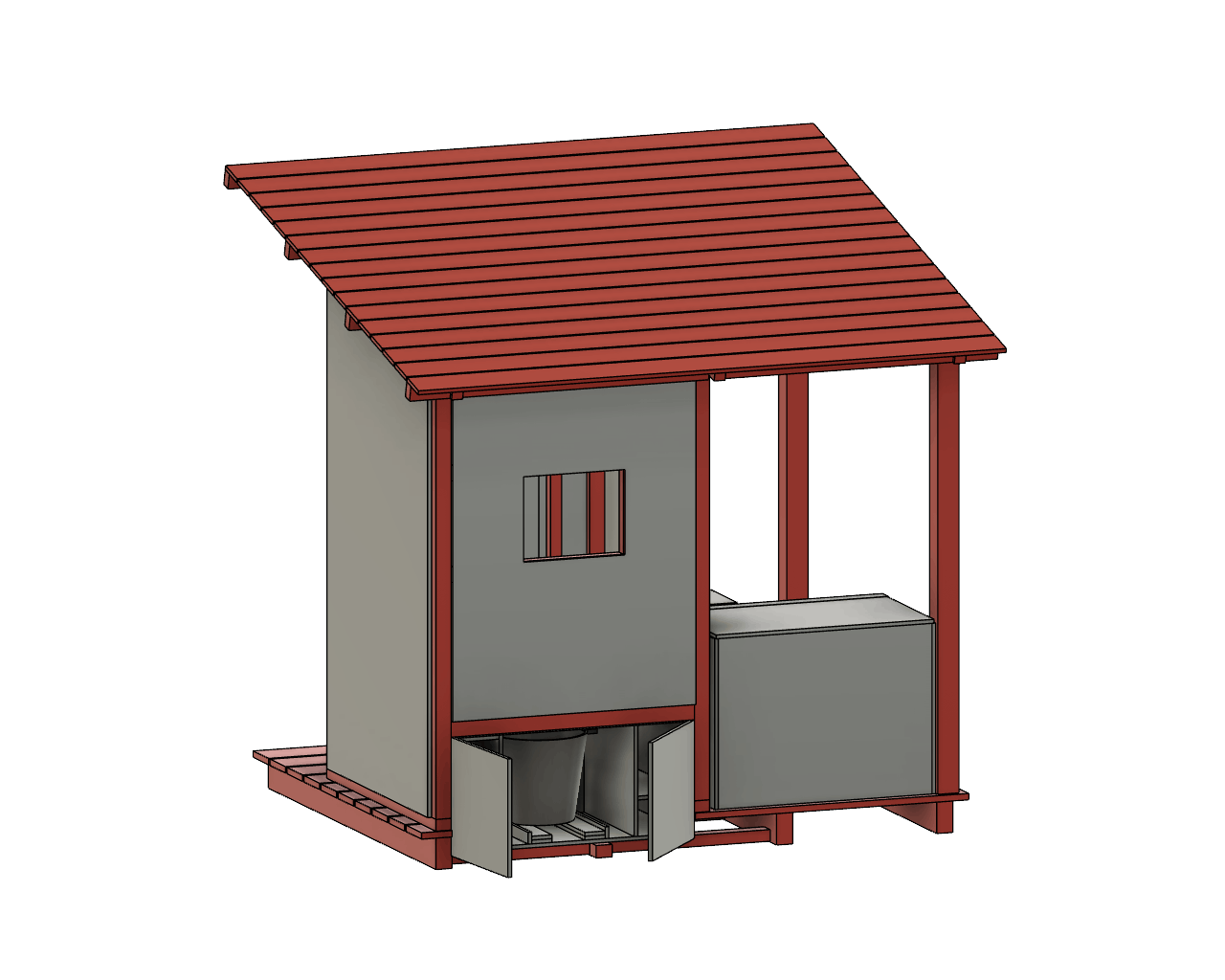

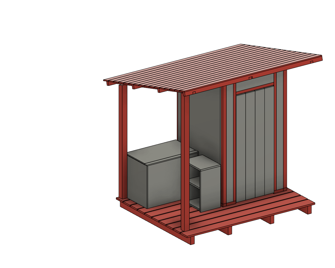

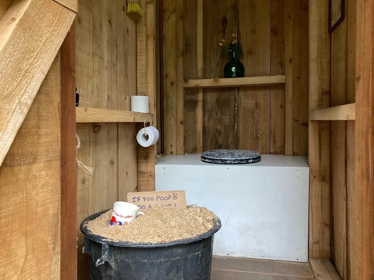

Design ready
After some days of thinking, and after reading the comments on the research, we have finally decided how our new toilet will work and how it will look like. Based on the capacities and necessities of the project at this point. We have our design ready and we would like to share it with you. - We are building the toilet next to the current one - We are going to continue using the plastic buckets for collecting the poop, pee and sawdust. For the new poop system. But that can be explained in another post ;) - We are adding a window to have natural light - We are creating a sink area so we have water access closer to the toilets - We are designing a sawdust storage box to store more sawdust than we currently do, and that will be connected to the inside of the toilet - We are building the toilet on top of stones so that the wood is not in contact with the ground - We are integrating the sawdust storage, period bucket and toilet paper in the same box

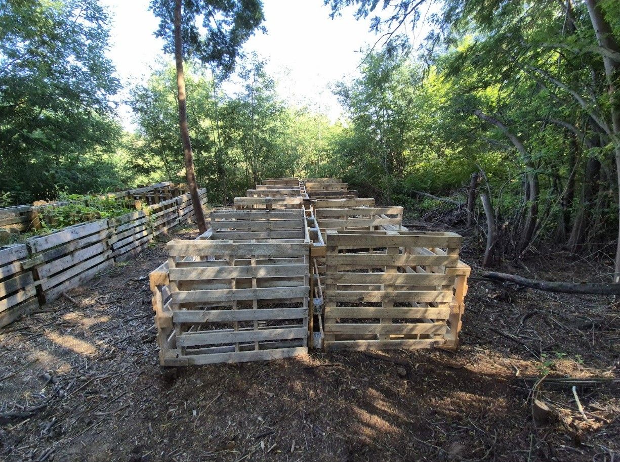

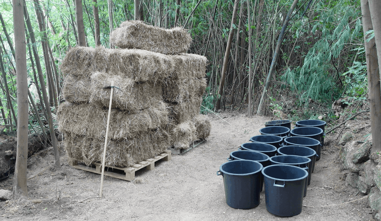

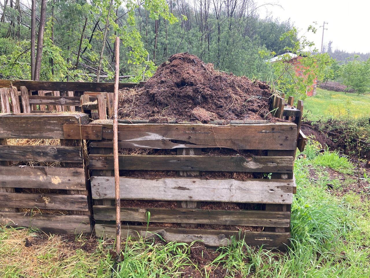

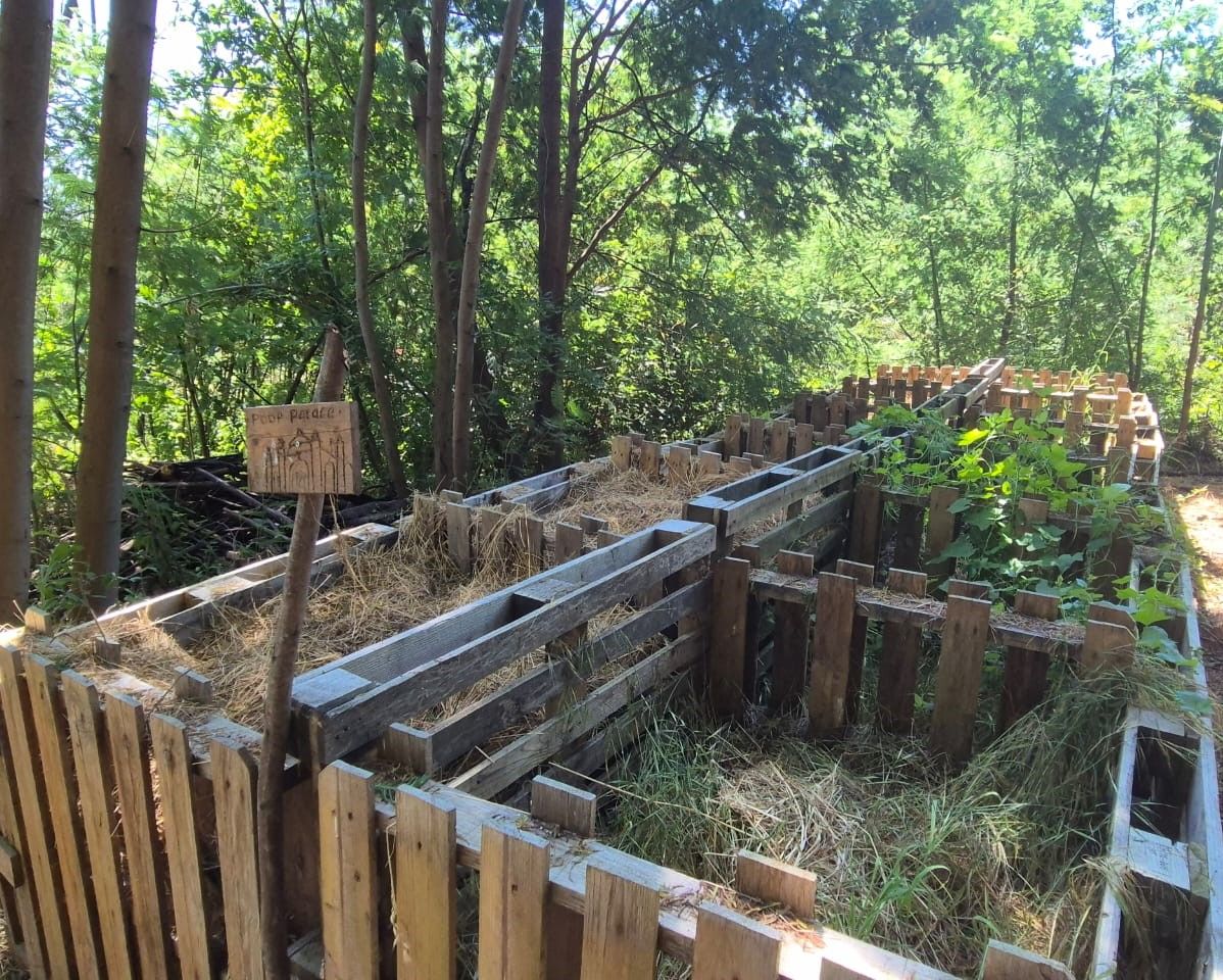

New Composting System (Part 1)

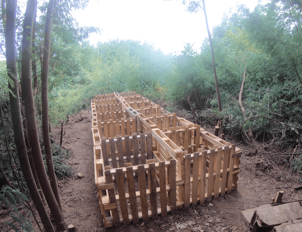

Hey everyone! We've made some exciting changes to our system based on your feedback and our research. We're now using a system inspired by the humanure handbook, with a few tweaks to suit our needs. But before we got started, we had some preparations to take care of. First, we cleared the area to create space for our bins, buckets, and hay. We made 12 compost bins using old pallets we got for free from nearby businesses. To save on pallets, we used 32 of them in a simple design. Since the pallets were different sizes and shapes, we used the bigger ones in the middle row and the smaller ones in the front, with the mid-sized ones in between. We also gathered hay bales from our land, thanks to our neighbor's help, and bought the necessary buckets. Lastly, we made sure to cover up the final poophole properly. We went for this approach because it solves many of the challenges we were facing, mainly saving us from digging holes but it will also help with the smell and flies issue.

Final result + drawings
We finished building the toilet! The video is out there. And also the drawings are available to download. Let us know if you have any suggestions on documentation, we are always up for improving :) 💪 Watch the video here: https://youtu.be/nhP8-rhU7ns 📁 Download the files: https://cutt.ly/FwfyQtA8

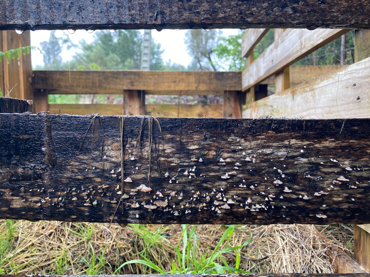

Toilet System Experience in Season 3

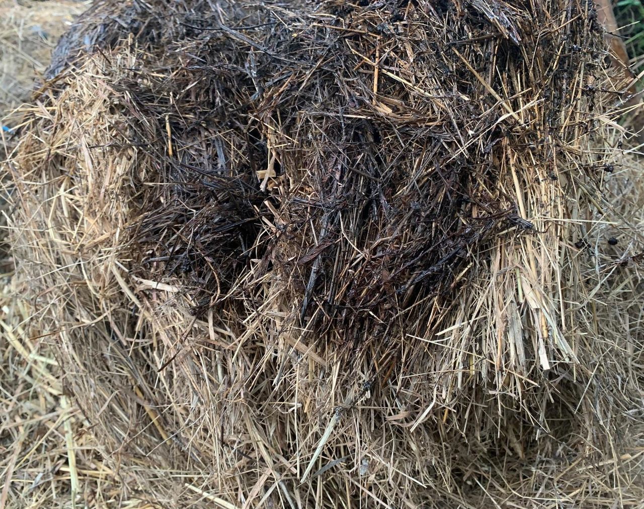

The second toilet and the poop palace that we built in season 3 have served us well, lasting about 6 months with 25 people living in Kamp. Things that worked well - - The second toilet as compared to the first one feels more spacious, has natural light, storage space for toilet paper and sawdust, and a wash basin to maintain hygiene. - The poop palace structure is sturdy and it held up well throughout the different seasons, even surviving the heavy rains. - The sawdust and hay cover up the smell well - you don’t smell anything even when close to the compost bins. - There are zero to very few flies around the poop palace. Things that need improvements - - The bins are filling up fast and we need to see if an addition of the same structure will be sufficient for accommodating 35 people in season 4. - We don’t have a system to store the hay needed and this can become a problem in the rainy season as the hay becomes moldy. - Cleaning the poop buckets is quite difficult and disgusting.

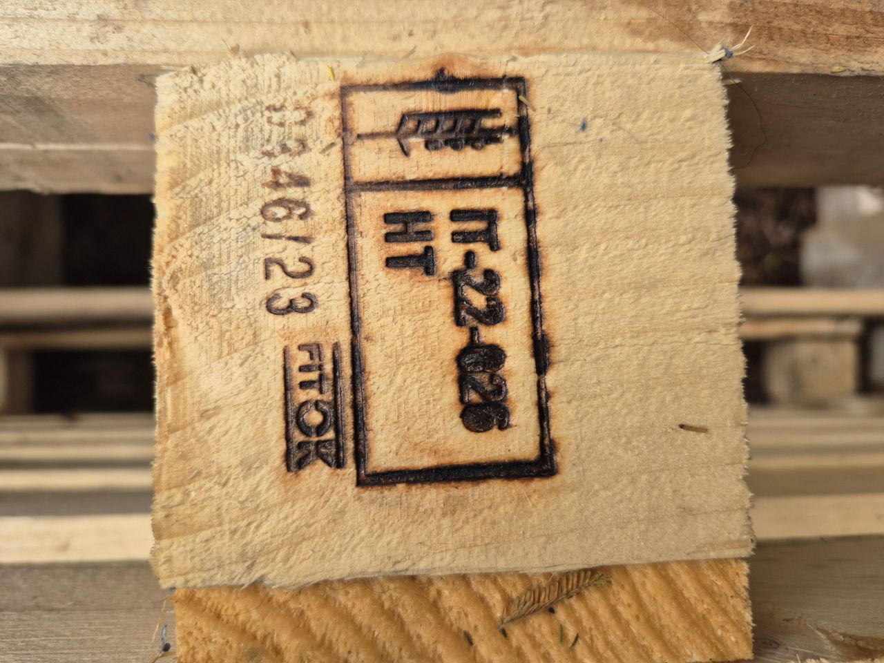

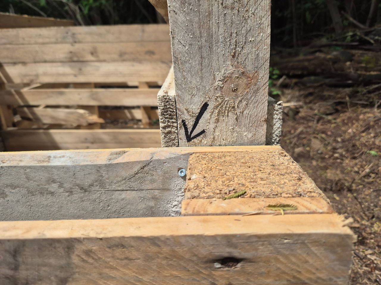

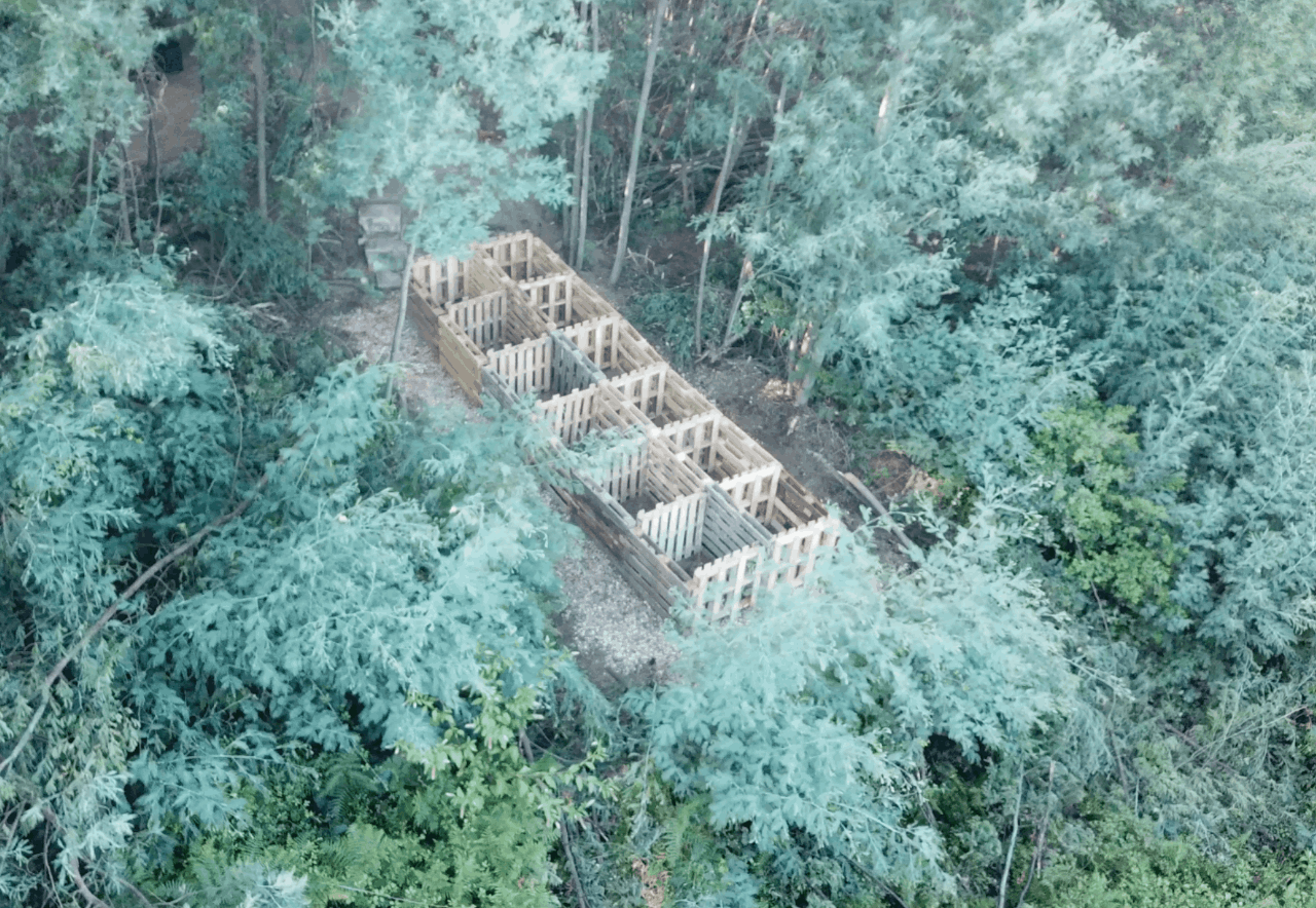

Expanding the Poop Palace
With all the 12 bins of the poop palace being filled and the compost not ready to be used yet, we could not empty any bins and have built a replica of the structure to create more space for all the human manure in season 4. -To build the structure, we've used Heat Treated (HT) Pallets that are free from any chemical treatment -We've built in a way that it's easy to open up in the future to take out the compost Challenges we anticipate in the future - -Finding out how much we need to wait for the compost to be ready and the bins to be emptied -How we are going to use the compost -We don't know if the two structures will be sufficient for the next few years or if further expansion will be needed soon

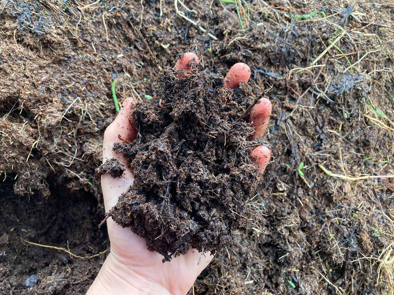

Compost toilet update
After two years of usage, with the expansions, we filled all compost brackets with our human waste. At this point we are confident that the first brackets we filled are ready to be used as compost. The compost looks good to be used, it is very crumbly, has an earthy smell, and we can not recognize any content of the starting material. Two years should be enough for the material to break down and become available for planting purposes. We have 24 brackets made of pallets filled and we plan to have this amount for now, so that we do not have to expand the poop palace again. Now we need more space for our human waste, so we are going to replace some of the compost from the first set of brackets and collect all of the material in another bracket. As we have no urgent need for this compost, we will leave it here for now, until the right opportunity arrives. We hope to use this in a place where we plant things that we are not eating. Still it would be nice to give it some use and not just dump it somewhere. With that being said, the aim of this composting system is to manage our human waste and not the compost itself as an outcome. Some clearing around the poop palace opened up the place almost completely, so now it is fully visible and out in the open. This makes us contemplate if we should replace the trees with something else instead. For one the brackets are now visible giving a sight not necessarily pleasing if you know what you are looking at. Secondly, until now it was mostly shaded, but now it will get full exposure to the sun. We don’t know how the sunlight affects this type of compost and we are worried it might attract more insects and create odor. Any advice on this? Another worry we have now is that the bottom of the wooden pallets seem to be deteriorating. This means that at some point they might become too weak to hold the material going into it, possibly collapsing. You can watch the video regarding these actions here: https://www.youtube.com/watch?v=ihOFMpXt3ds&ab_channel=ProjectKamp
